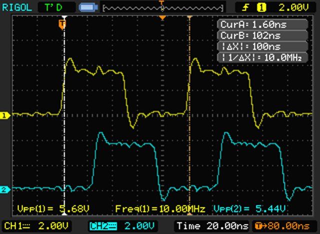

CM7:

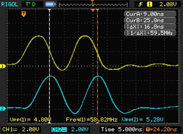

CM4:
The CM7 needs for a single output operation about 25ns and the CM4 4,2ns. Why is the CM7 slower than CM4?

2022-04-07 6:05 AM
This is a known behavior in H7 family. Please check out these discussions in the community:
https://community.st.com/s/global-search/stm32h7-gpio-togle-max-frequency
2022-04-07 7:12 AM
The GPIO's are parked way off on AHB4/APB4, the M4 is closer, look at the organizational diagram.
>>is it possible to improve the GPIO performance on the core CM7?
Perhaps use the function to write the state of both pins together? Pretty much double the toggle rate right there.
Most people don't use a 400 MHz MCU to do this, couldn't you drive with a TIM, or a CPLD if you want wire-speed operation?
2022-04-13 1:22 AM
Thank you for your feedback.
I performed some further measurements using the DWT and an oscilloscope. It seems I have to accept the longer GPIO times of the CM7 core.
Summary of my measurements:
Core CM7, 480MHz
LL_GPIO_SetOutputPin(DBG_D1_GPIO_Port, DBG_D1_Pin); // 12 cycles, 25ns
LL_GPIO_ResetOutputPin(DBG_D1_GPIO_Port, DBG_D1_Pin); // 12 cycles, 25ns
WRITE_REG(TIM1->CCMR1, 0x00000050); // TIM1 CH1 FORCED_ACTIVE; 8 cycles, 16,7ns
WRITE_REG(TIM1->CCMR1, 0x00000040); // TIM1 CH1 FORCED_INACTIVE; 8 cycles, 16,7ns
Core CM4, 240MHz
LL_GPIO_SetOutputPin(DBG_D1_GPIO_Port, DBG_D1_Pin); // 1 cycle, 4,2ns
LL_GPIO_ResetOutputPin(DBG_D1_GPIO_Port, DBG_D1_Pin); // 1 cycle, 4,2ns
WRITE_REG(TIM1->CCMR1, 0x00000050); // TIM1 CH1 FORCED_ACTIVE; 4 cycles, 16,7ns
WRITE_REG(TIM1->CCMR1, 0x00000040); // TIM1 CH1 FORCED_INACTIVE; 4 cycles, 16,7nsKind regards
