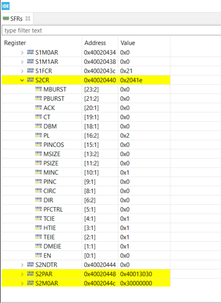

2021-03-08 2:44 AM
Yes, DMA2 Stream 2 configuration register gets set in HAL_SPI_Receive_DMA function
Here is register :
2021-03-08 2:55 AM
Okay, so if
then either breakpoints don't work (this can be circumvented by toggling a pin and observing in the ISR), or, which IMO may be more probable, processor runs with interrupts globally disabled or at a priority level which is higher than the ISR in questions' priority. I am lazy to look up how to check easily either of these, both involve looking at SCB registers.

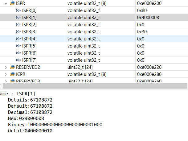

2021-03-08 3:10 AM
@Community member
Thank you for the help,
NVIC Pending register after first Rx : The bit 35 is 1 (SP1) and the bit 58 is 1 (DMA2 Stream 2), but my breakpoints in both Handler aren't triggered (I will try GPIO debug)
For priority, I registered my interrupts at level 0 or 1 (highest) because in my application SPI1 Rx is the most critical process
2021-03-08 5:32 AM
Maybe interrupts are globally disabled.
This is in PRIMASK, which is a processor internal register, I don't know if and how your debugger can display it.
Also, you may be inside an interrupt of the same or higher priority. Check IPSR (again, a processor internal register).
You can also have a look at the SCB_ICSR register, that should contain the currently executed interrupt number (or 0 if no interrupt), too.
