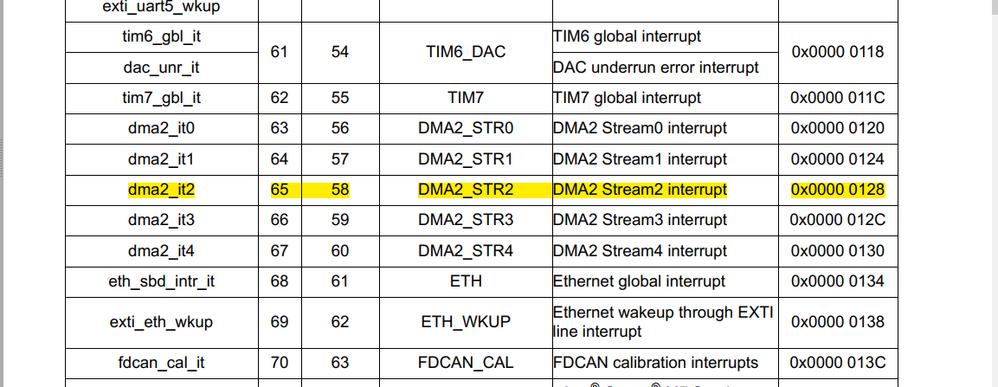

Update I also checked NVIC ISER and NVIC->ISER[1]=0x400 0000 which means the bit 58 is 1, it is DMA2 Stream2 interrupt

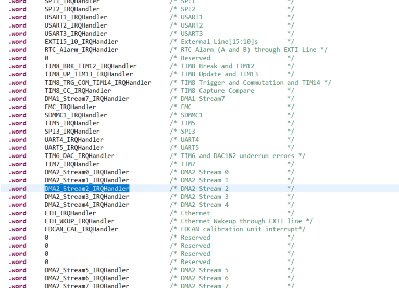

Is a function DMA2_Stream2_IRQHandler implemented somewhere? This is your handler.
This name must be exactly same as defined in your startup_stm32h743xx.s

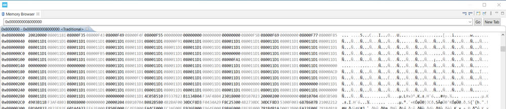

You get the ISR address from mapfile or disasm view of that function in IDE, and then dump content of vector table e.g. in memory view of IDE.

In my startup_stm32h743xx.s, DMA2_Stream2_IRQHandler is registered here :
And in "stm32h7xx_it.c" :

From looking at map file, DMA2_Stream2_IRQHandler address is 0x0000000008000fa0
With memory browser, I see a 08000FA1 value at 0x8000128 address.
It is the correct position and value (good news but bad news for diagnostic)
Also I checked and SCB->VTOR = 0x8000000
