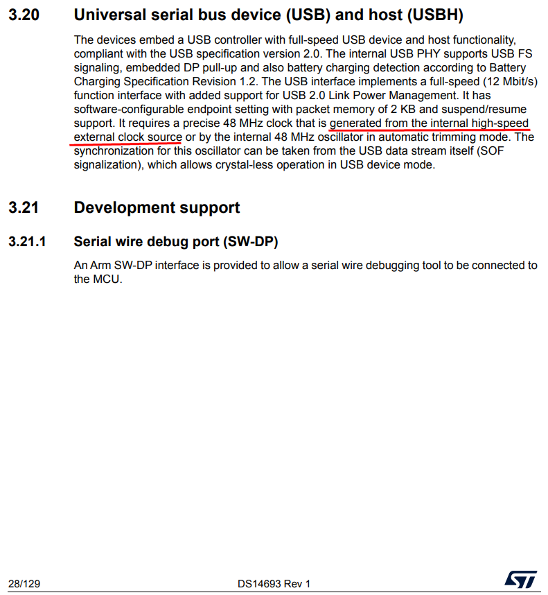

Section 3.20: "It requires a precise 48 MHz clock that is generated from the internal high-speed
external clock source"
So we have "internal external" clock source. ;)

https://www.st.com/resource/en/datasheet/stm32c071kb.pdf#page=28

@Andrew Neil wrote:
So it does!

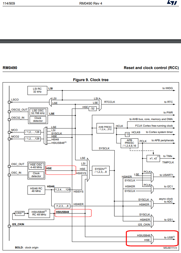

I think there is something missing in the statement. There are two possible clock sources: HSIUSB48 and HSE.
2024-10-21 2:09 AM
So what they mean is, "HSE or HSIUSB48":
Yes, it does mention the two:
external clock source or by the internal 48 MHz oscillator in automatic trimming mode"
So
I guess what they meant to say was something like, "HSE routed internally" ?

Hello @gbm ,
Indeed, the word "internal" is a typo. The right sentence would be: "It requires a precise 48 MHz clock that is coming from a high-speed external clock (from an external source or an oscillator) or by the internal 48 MHz oscillator in automatic trimming mode."
This typo will be fixed for the next document revision. Thanks for spotting this typo, and enjoy the STM32C071 !
