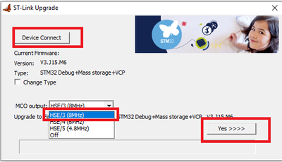

I suggest to set the clock source in Bypass mode and
Use STLINK-MCO output as clock source for the system clock and select one of the PLLs output for FDCAN clock source.
For this you need to download ST-LINK firmware upgrade tool from here: https://www.st.com/en/development-tools/stsw-link007.html
connect to ST LINK and select one of the STLINK-MCO HSE clock source (to select 8MHz as external clock) as indicated in the following figure:
I propose you that clock config with a FDCAN timings at 500kb/s (ioc in attachment)
Hope I answered your question.

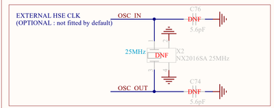

Humm well and thank you for the sharing.
Still one thing to check:
In the schematics HSE crystal is not fitted:
and in your clock config you set HSE to 24MHz as an external clock source. Did you solder that 24MHz crystal with its respective capacitors?

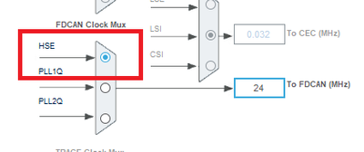

Just noticed that your RCC clock source is set to HSI (64MHz) in your ioc file:
Could you please confirm/check?
2024-06-12 7:43 AM
Sorry: Discard my previous comment about HSI clock source in your ioc file as your FDCAN clock source is HSE:
So please tell if you've already soldered a 24MHz crystal with its respective capacitors!

No I havent soldered anything yet on the Nucleo board. I dint really think HSE would require me solder anything on the nucleo board... My Apologies!!
To resolve the can bus issue now, should I use PLL1Q (42.6667 Mhz)? If yes, can you please recommend some Bit Timing Parameters as well for a few common baud rates.
