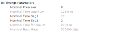

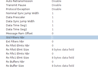

Hi guys i have a nucleo h7A3Zi-q dev board . i am trying to receive CAN messges sent from ESP32 borads . esp is sending can frame by using SN65HVD232D. and i configured the FDCAN to receive the can messages . esp can is set at 500 kbits , and my stm configurations is like this

I don't know about ESP, you need to check your ESP CAN configuration. You should have the same CAN bitrate.
For the timing and as you are using Classical CAN, you can refer to this knowledge base, it was written for bxCAN but the principle is the same: select a sample point at about 87.5%: CAN (bxCAN) bit time configuration on STM32 MCUs

You are using a standard ID filter while ID2 is an extended ID!
Use Mask ID with all filters IDs set to 0 if you want to receive all the CAN messages.
Did you enable the NVIC interrupt line for FDCAN?

And also whats the use of data prescaler timeseg1,timeseg2 . how to cofigure them , and is that improtant
2025-12-23 12:19 AM - edited 2025-12-23 12:36 AM
