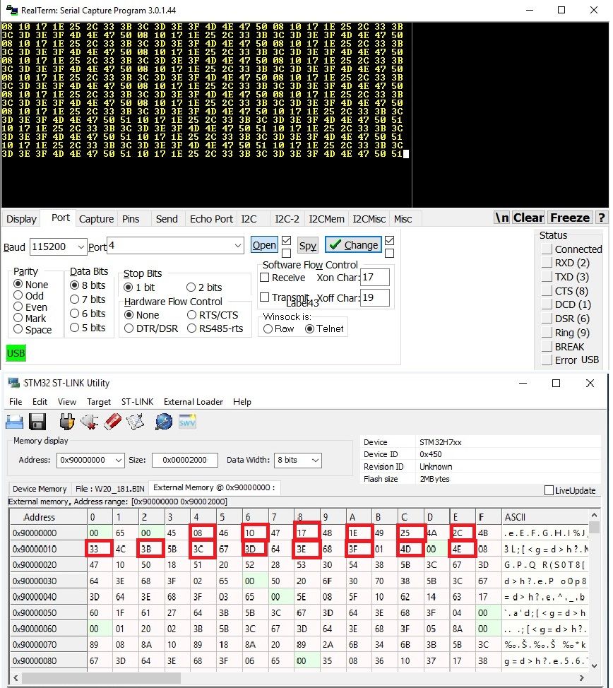

I am trying to communicate to a flash memory using the STM32H750 micro and its QUADSPI interface. For this I use the STM32H750B-DK Discovery board which provides a dual external flash
memory (MT25QL512). In my first example I am just trying to read some memory locations which I previously pogrammed suing the ST-Link Utility.
The program is straightforward, I read 16 bytes at the time and I print them using the UART interface. The problem I am experiencing is the following: it seems that one byte every two is skipped. Please look at the pictures above showing the content of the memory (ST-LINK Utility) and the output of the virtual port. (Attached view of terminal and memory content)
What am I doing fundamentally wrong?

2019-09-02 3:35 AM
This looks strange:
hqspi.Init.DualFlash = QSPI_DUALFLASH_DISABLE;
You use only one flash chip, and hence you get only every other byte.
2019-09-02 3:40 AM
It is look likes ST-Link Utility flash data in QSPI_DUAL_FLASH mode. So you also need read data with QSPI_DUALFLASH_ENABLE option.
2019-09-02 6:07 AM
Dear @oleksandr.karbivsky , thank you for your answer. I modified the project adding the dual memory interface and it works fine. Therefore it seems that as you said STLink flashes the data in dual mode. I am wondering if there is a way to select SINGLE mode. I will do another test writing to the memory from the uC and reading back. Thank you very much, Matteo
