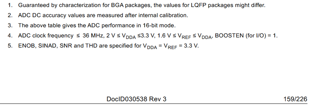

2024-07-23 5:55 AM - edited 2024-07-23 5:57 AM
>A more unfortunate thing is that after reading AN5354, I see that the ADC clock is also limited by the package. Using 3 ADC, for my LQFP144 the max clock is 30MHz and not 50MHz as specified in the datasheet. Very bad that the datasheet don't mention anything about that.
Your not right - in ds there are more or less clear indications of the problem - but no clear values.
see on top of ADC chapter...the most important footnote !
>> "might differ " --> = everything else is worse. (But this was deleted by the marketing departrment . :) )
It is the an5354 (and maybe others..) to read.... to really know.
