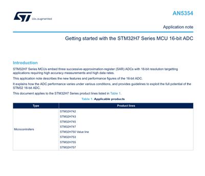

for our H7 series and 16-bit ADC you can refer this Application Note for general guidelines to improve the accuracy including calibration. https://www.st.com/resource/en/application_note/an5354-getting-started-with-the-stm32h7-series-mcu-16bit-adc-stmicroelectronics.pdf
