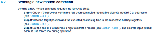

We are told this from Manual UM2653: Getting started with the EVALKIT-ROBOT-1 - User manual
IF we concentrate on these steps one at a time – we should be good! Right ?

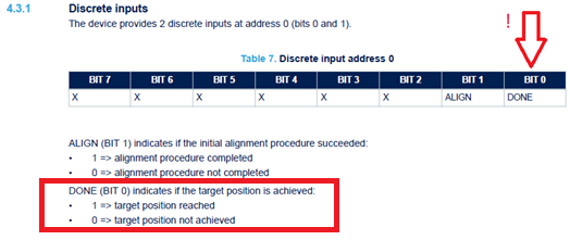

So step 1 wants us to make sure bit 1 here is set using the information at section 4.3.1!
4.3.1

00 (MODBUS DISCRETE INPUT VALUE) ????????????? BIT NOT SHOWING as SET “1”

02 (MODBUS DISCRETE INPUT VALUE) ???????? (ALIGN BIT SET but DONE BIT CLEARED)
