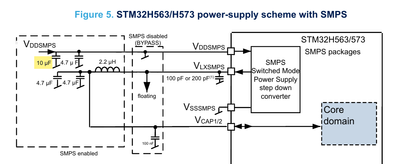

2025-08-07 7:02 AM
Hmm, not real sure. Looks like you're missing this recommended 10 uF cap, but I'd be surprised if that was the issue.
Is the SWD connection solid? Do you have another cable or programmer you could try?

I have tried adding the 10 µF capacitor, but the issue still persists.
