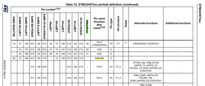

I am using the STM32H573RIV6 for my project and would like to use the USB interface. However, according to the datasheet, the VDDUSB pin is not available for the VFQFPN68 package. Does this mean the USB feature is not available for the STM32H573RIV6? This is not specifically mentioned in the datasheet.

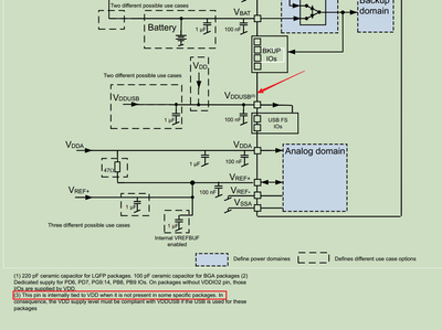

You should refer to  AN5711, Getting started with STM32H5 MCU hardware development , which said " This pin is internally tied to VDD when it is not present in some specific packages. In
consequence, the VDD supply level must be compliant with VDDUSB if the USB is used for these
packages

Indeed, no matching between this package VFQFPN68 and VDDUSB

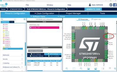

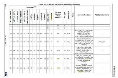

But as per the pin definition, PA11 (Pin 47) and PA12 (pin 48) can be used as USB_DM and USB _DP, also STM32CubeMX Verified this
Hi :
packages

Thank you, this information helped lot, I am using VDD supply as 3.3V in the design, so I should be able to use the USB feature.
