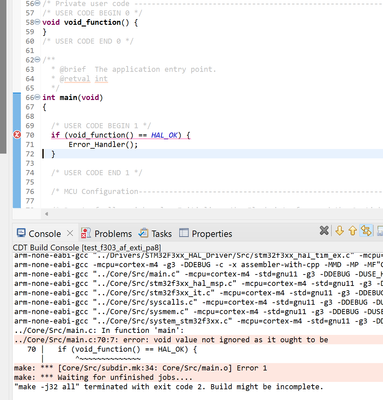

This shouldn't even compile. HAL_PWREx_EnableUSBVoltageDetector does not return a type.
If CubeMX is generating this, it's a bug in CubeMX. Please attach your IOC file.

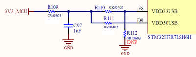

Hi @Kaushik1
Would you increase the PWR_FLAG_SETTING_DELAY : e.g. multiply it by 10 to see if the issue persists?
For STM32H7RS, when USB is not used, you can connect VDD33USB to 0 V to minimize any possible leakage. Also, USB33DEN should be set if a GPIO on port M is used.
It is mentioned in this knowledge base article.

@TDK wrote:This shouldn't even compile. HAL_PWREx_EnableUSBVoltageDetector does not return a type.
But, in an expression, the function still has a value - which is its address.
So it should compile - but it won't do what's intended!
@TDK wrote:If CubeMX is generating this, it's a bug in CubeMX.
Agreed!
2025-11-06 8:16 AM
A void function does not return a value and cannot be used in an expression.
Its value is not its address--that's nonsense.
2025-11-06 8:52 AM
@TDK wrote:Its value is not its address--that's nonsense.
You're right - that only applies without the parentheses.
So the code @Kaushik1 presented can't be the real code
