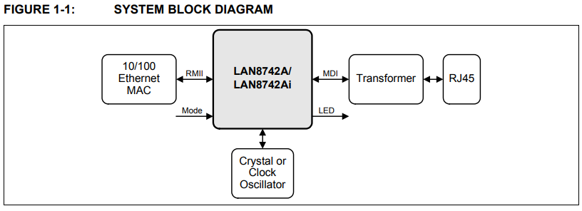

Although you are using MII mode in your configuration, the PHY integrated with the STM32H573, specifically the LAN8742A/LAN8742Ai, communicates with the MCU via a standard RMII interface and is clocked using a 25 MHz crystal oscillator according to the datasheet. In your case, the 100 Mb/s-MII mode was selected by the auto-negotiation process between the two boards, which explains the 25 MHz clock signal you observe on your scope.
As shown in the PHY block diagram, the LAN8742A/LAN8742Ai supports communication with the Ethernet MAC through RMII, providing full-duplex 10BASE-T/100BASE-TX operation at 10 Mbps and 100 Mbps speeds.
