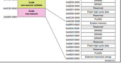

Hi @Recep ,
You need to modify the SRAM address as showing :
SRAM1 : 0x0A00 0000
SRAM1 : 0x0A04 0000
SRAM1 : 0x0A05 0000
Foued
