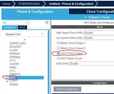

Just getting started with this MCU.
STM32CubeIDE says LSCO has conflict with GPIO input on PB2. Using this IDE how do I disable LSCO?
2023-08-02 3:49 PM
Disable the LSCO Clock Output in the RCC tab.
