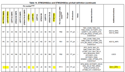

The pins don't exist on that chip.

Thank you. It would be helpful if RM0481 mentioned that.

DS14258 mentions this.

Chip specific things will be found in the datasheet.
