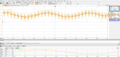

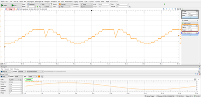

Im working on a program which sends data from the ADC to the computer. My problem is that the data from my STM32H563ZIT6 is bad. I first noticed this from looking at the data sent from the computer and confirmed this by outputting the ADC data through the DAC. Attached is the output from a 50Khz sine wave.
I am not sure what is causing this stair stepping pattern. For reference I have the ADC clock at 75Mhz, 6.5 cycle sample time, and triggered by a 1Mhz timer.

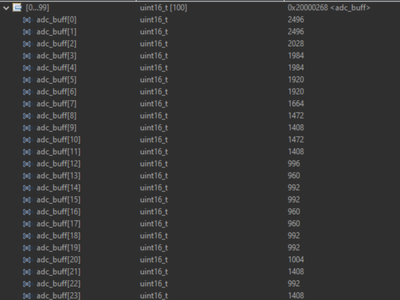

I did notice that the data in the buffer seemed to be mostly shifted left 4 bits (though it never goes above 4095) or is missing the first 4 LSBs.
I ran the same program on an STM32F303RET6 and got the expected output from the DAC.

Update rate is 1 MHz, steps occur every 1us. Seems consistent. If you want a lower bandwidth, use a low pass filter on the output. Looks like an error in some of the calculations is causing the spike near the top of the wave. It's repeatable across periods--probably a bad value.
The adc_buff values seem off. Lots of duplicates. Probably a bug in the code there.
Not sure I believe these are the same program. The amplitude on the H5 example is 3V and 50 mV on the F3 example.

adc_buff is uint32_t in the code and uint16_t in your screenshot. Clearly not getting a consistent story here.
