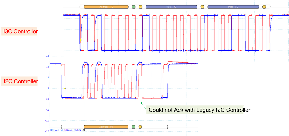

2023-06-13 3:54 AM - edited 2023-11-20 3:27 AM
Hi @KHALSI_Foued ,
I have some new discover.
I found my I3C Target could ACK to the I3C Controller.
But it could not response correctly to the Legacy I2C Controller, even both of them are sending same signal:
Why is it happening?
Is there any way to fix it?
By the way, below are my code for I3C Controller:

2023-06-13 6:23 AM
hello @BLAI.1 ,
There is no way to communicate I2C controller with I3C target features, you can just work on I3C bus to improve the features of the I2C interface preserving some backward compatibility.
Foued
