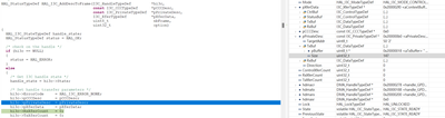

After running debug, the error occurs in "static HAL_StatusTypeDef I3C_Xfer_PriorPreparation()"
condition (global_tx_size > hi3c->pXferData->TxBuf.Size) will always be satisfied unless 'aTxBuffer[]' has more than 147 elements.

2024-06-19 4:40 AM
Hi Foued,
I tried the code that you suggested, and the system stuck in the same place.
I found out that 'global_tx_size' came from 'pPrivateDesc.TxBuf.Size', which was set at line 2167.
However, I think I fix this problem after this modification.

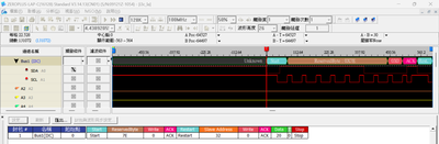

};I could capture a waveform as below:

Q2:
It seems that the system successfully transmit a data (0x20), but why?
Shouldn't the expected value of this data be 0x0F?
uint8_t aTxBuffer[1] = {0x0F};

2024-06-21 2:41 AM
Hello @SteveDu ,
1/ You can modify the size of the Tx buffer and the Rx buffer to receive more data.
2/ Could you check the datasheet of your device ( I3C target ) for more details about registers ?
