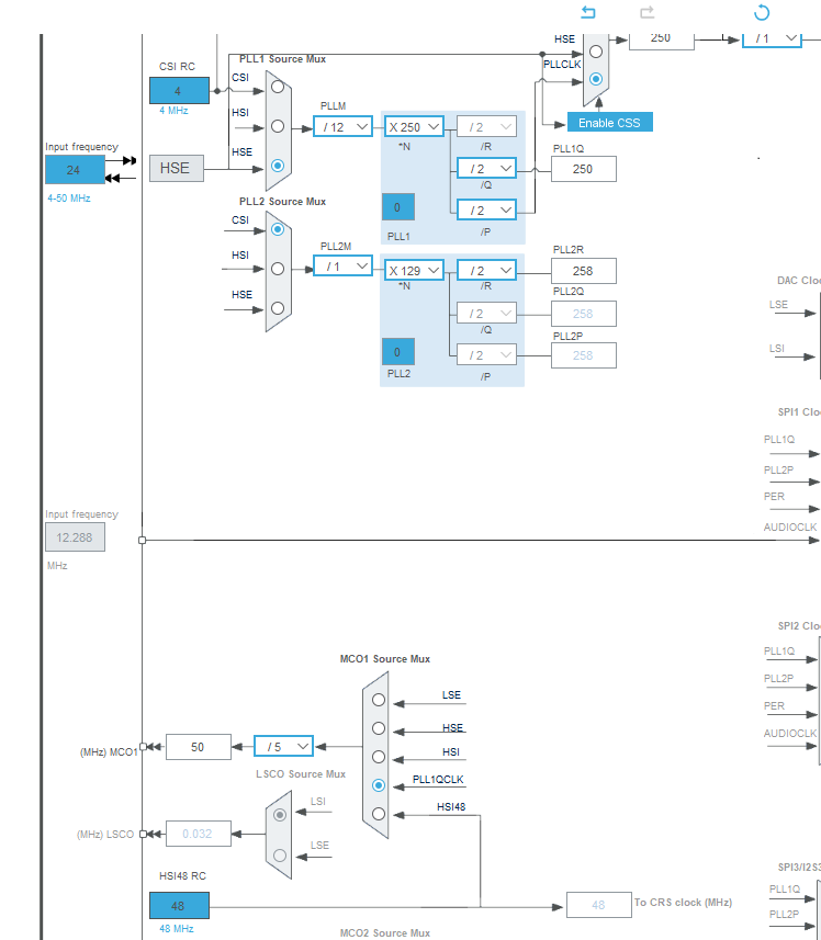

PLL1 is configured as:
HSE=24Mhz crystal
M= /12, N=x250, Q = /2, and MCO divider = /5 So output should be 50MHz

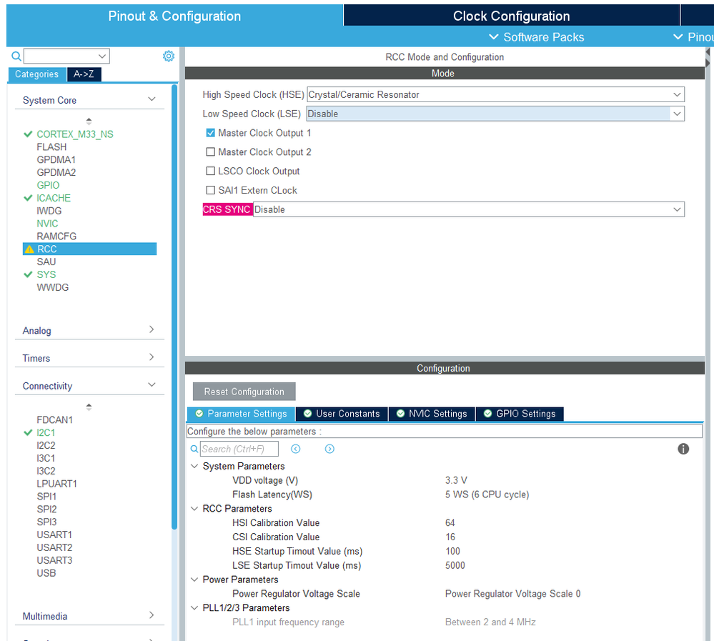

I anyone would like to reproduce it, it is very easy to reproduce.
Build a project in CubeMX for the Nucleo-h503RB board.
NOTE: You have to manually set the pin drive strength to VERY_HIGH because CubeMX will default it to LOW.
Configure the clock tree as follows:
You will get no output on MCO1 (PA8 which is pin D7 on the Arduino connector on that Nucleo board).
Now, re-test, changing the MCO1 clock source to any of the other choices and you will get the expected output. Try changing to using different dividers and same results--no output with PLL1 but works with the others. (I tried all the way to /15 which is the max for MCO1).

- The STM32H503 in LQPF48 packages does not have MCO2 available, only MCO1. Why does the screenshot for the RCC peripheral show MCO2 as being available?

The "simple" repro I did above (screenshots) was with the Nucleo board, which does NOT have the LQFP48 package (so it does have the MCO2 pin). I did that because it's easier for people in the forum to repro with that than with an LQFP48 which has no Nucleo board available. I confirmed that the same problem exists with both chip packages.
