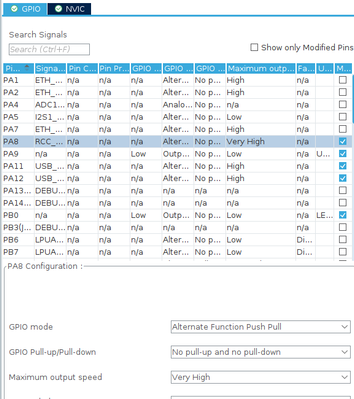

and you set speed for mco hi ?
2024-01-25 7:11 AM

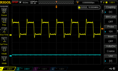

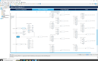

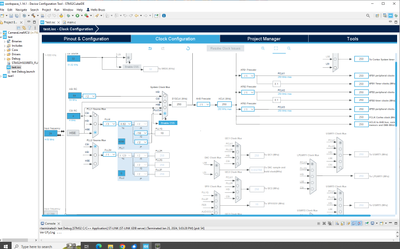

Yes i have set " very high" speed. I see other interestig: if i choice source to MCO1 to be HSE or CSI , on MCO1 pin have a signal. And signal is exacly frequency according source , BUT if i choice PLL1QCLK - NOT SIGNAL.:
2024-01-25 7:43 AM
btw
set the pll1 fractional divider :0
2024-01-25 8:08 AM
I set it 0 or other value , no mater. Just check and you will see that if you select for source PLL1Q - not signal !! Just test it. I see you dont trust me. JUST TEST !

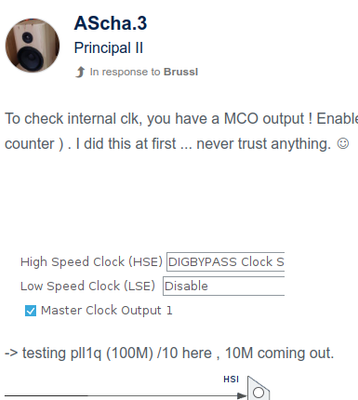

try same setting (100M -> mco/10) - otherwise i have no idea, why it shouldnt work on your H563.

clk (8MHz) coming from st-linkV3 -> HSE bypass setting.
