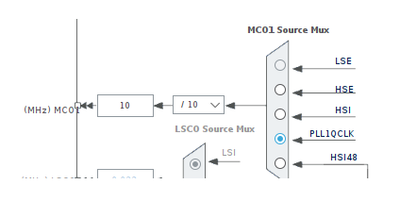

To check internal clk, you have a MCO output ! Enable it, select the clock to test and test on mco pin with scope (or counter ) . I did this at first ... never trust anything. :)
-> testing pll1q (100M) /10 here , 10M coming out.

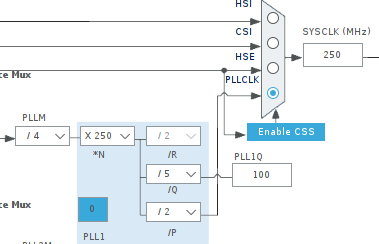

+ here SystemClock_Config , just as cube puzzeled it together:
void SystemClock_Config(void)
__HAL_PWR_VOLTAGESCALING_CONFIG(PWR_REGULATOR_VOLTAGE_SCALE0);
while(!__HAL_PWR_GET_FLAG(PWR_FLAG_VOSRDY)) {}
RCC_OscInitStruct.HSEState = RCC_HSE_BYPASS_DIGITAL;
RCC_OscInitStruct.PLL.PLLSource = RCC_PLL1_SOURCE_HSE;
RCC_OscInitStruct.PLL.PLLM = 4;
RCC_OscInitStruct.PLL.PLLN = 250;
RCC_OscInitStruct.PLL.PLLP = 2;
RCC_OscInitStruct.PLL.PLLQ = 5;
RCC_OscInitStruct.PLL.PLLR = 2;
RCC_OscInitStruct.PLL.PLLRGE = RCC_PLL1_VCIRANGE_1;
RCC_OscInitStruct.PLL.PLLVCOSEL = RCC_PLL1_VCORANGE_WIDE;
RCC_OscInitStruct.PLL.PLLFRACN = 0;
Error_Handler();
|RCC_CLOCKTYPE_PCLK1|RCC_CLOCKTYPE_PCLK2
|RCC_CLOCKTYPE_PCLK3;
RCC_ClkInitStruct.APB2CLKDivider = RCC_HCLK_DIV1;
RCC_ClkInitStruct.APB3CLKDivider = RCC_HCLK_DIV1;
cpu at 3v3 , source ...is on NUCLEO-H563ZI board...hse bypass , set :8MHz .

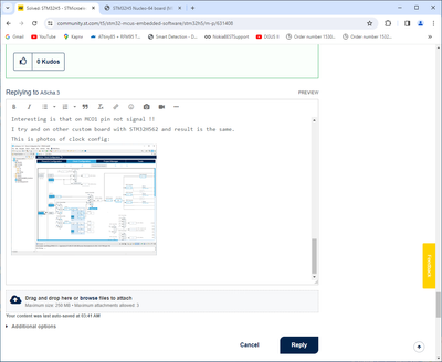

Interesting is that on MCO1 pin not signal !!
I try and on other custom board with STM32H562 and result is the same.

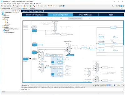

This is photos of clock config:

Some one to help ? I can't start project 3 days. Just simple 250mhz setup i can't make with extarnal qartz. Where is f..ng problem. I use last lib of stm32H5 1.1.1. My be something in library is not OK!? Why frequency a half of 250 mhz and why on MCO1 pin not signal ? I check frequency of quarts and is 24mhz. So my scope measuring ok.
I see when use HAL_Delay(1) that delay time is not 1 ms but 2ms. SUPER STRANGE !!!

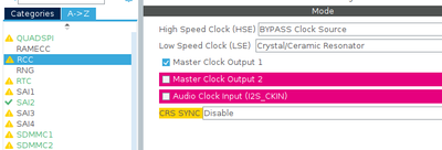

So first : why on MCO1 pin not signal ? This cannot be...we dont allow! :)
set mco in Cube (?) ->
then set the mux:
and check : input is the real value on your board ? :
on my H563 nucleo : is 8MHz !
Now check mco1 output ...!
2024-01-25 3:31 AM
I set only in cubeMX. Please measure frequency with HAL_Delay in loop. And if you have output from MCO1 too measure it. I have not output form MCO1. Please check which is your version of HAL. I use last one.1.1
