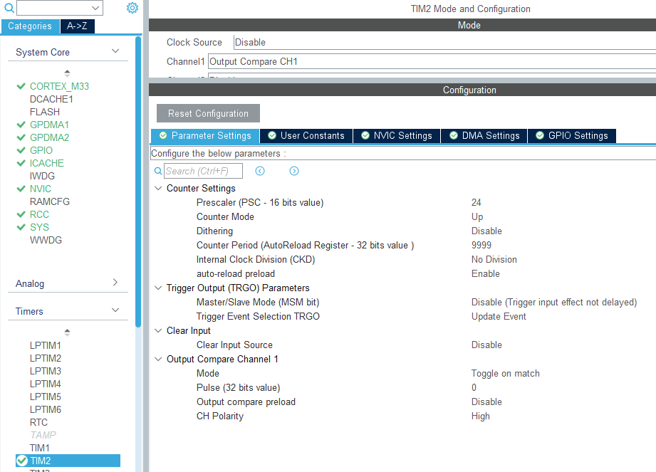

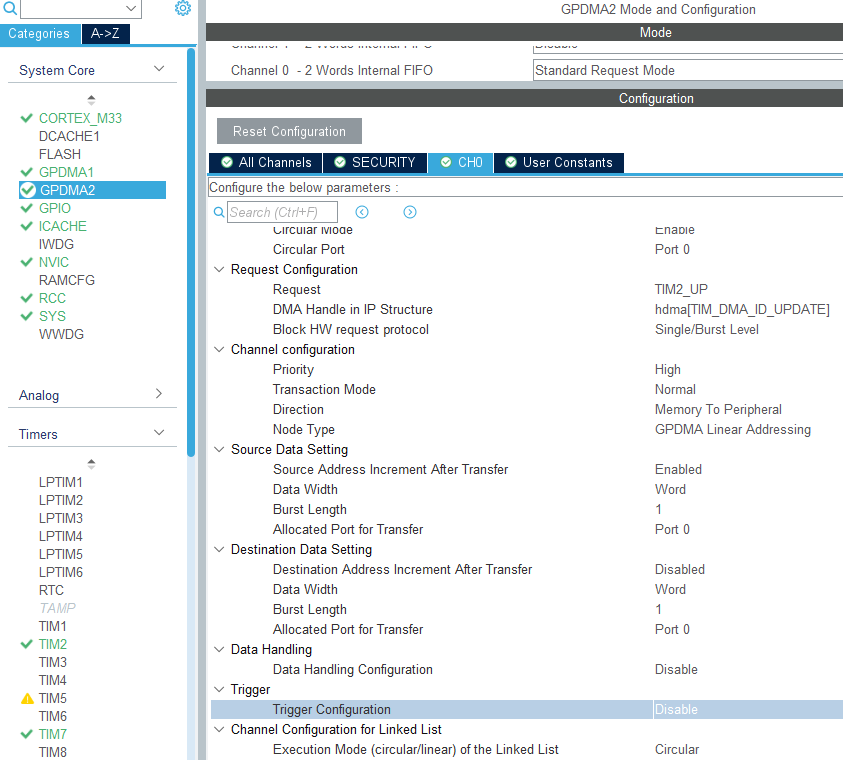

...where the DMA is much simpler. Section 3.7 of AN5593 (How to use the GPDMA for STM32 MCUs) doesn't provide much information on GPIO control, but does mention using memory-to-memory transfers. I have tried both memory-to-memory and memory-to-peripheral circular DMA transfers without success. Like the F103 example, I am using the TIM2 output compare CH1 as the request event for a DMA transfer. My scope indicates that TIM2 CH1 is toggling properly every millisecond, but no signal comes from the GPIO pins. I've tried myriad permutations of modes and requests/triggers with no success.

HAL_TIM_Base_Start(&htim2);
for (int i=0; i < sizeof(pixelclock); i++)
pixelclock[i] = 0;
// the pixelclock goes straight to the BSRR register
// [31 ... 16] are reset bits corresponding to Ports [15 ... 0]
// [15 ... 0] are set bits corresponding to Ports [15 ... 0]
// if a reset bit is set, the GPIO port will be set LOW
// if a set bit is set, the GPIO port will be set HIGH
pixelclock[ 0] = 0x00000001; // set SI signal on 1st clock edge
pixelclock[ 2] = 0x00010000; // reset SI signal on 3rd clock edge
pixelclock[ 9] = 0x00000002; // set the ESH signal high
pixelclock[13] = 0x00020000; // set the ESH signal low
status = HAL_DMA_Init(&handle_GPDMA2_Channel0);
if (HAL_OK == status) {
// DMA, circular mode, full word (32 bit) transfer
status = HAL_DMA_Start(&handle_GPDMA2_Channel0, (uint32_t)pixelclock, (uint32_t)&(GPIOC->BSRR), sizeof(pixelclock));
HAL_TIM_OC_Start(&htim2, TIM_CHANNEL_1);
TIM2->DIER |= TIM_DIER_UDE; // set UDE bit (update dma request enable)
while (1) { TIM2 Parameters
