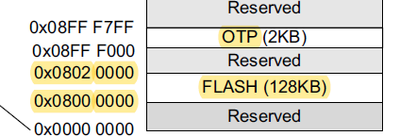

But still meet hardware fault when accessing OTP area. What's the restriction when use MPU to disable ICACHE?
or, if I want to disable ICACHE for whole OTP area, what should I do?

I am attempting the same thing as @Dahua , on the STM32H503, with no success. I've tried using your MPU config template, but with the following addresses:
region.BaseAddress = 0x08FFF000;
region.LimitAddress = 0x08FFF7FF;
The program still hangs when I try to read OTP memory:
volatile uint16_t *p = (uint16_t *) 0x08FFF000;
uint16_t v = *p;
Same thing with a 32-bit access.
This occurs whether ICACHE is globally enabled or disabled.
Any idea what I'm doing wrong? Thank you.
