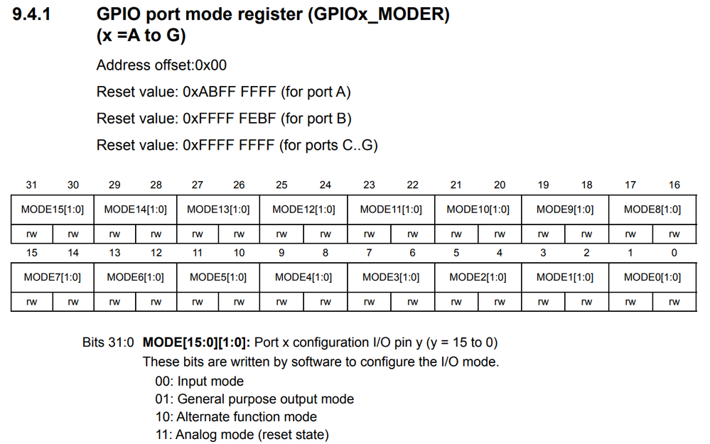

Most GPIO pins are in high impedance analog mode during startup. There is no way to change this. The configuration you choose in CubeMX doesn't get activated until your program starts to run. There are some exceptions, but they are all listed in the GPIOx register values in the reference manual.
If you need pins to stay low, you will need to add an external pulldown.
Specifying a pulldown on an output pin does nothing but potentially waste current if the pull resistor is fighting the current output level.

Thanks a lot TDK. I will go with your suggestion of adding an external pulldown.
