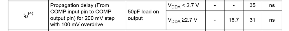

Hi i am planning to use internal comparator.
The propagation delay for comparators are 31nS which is at 25 deg C
Can you please let me know what is the all drifts and all propagation at 125 Deg C?
Thanks

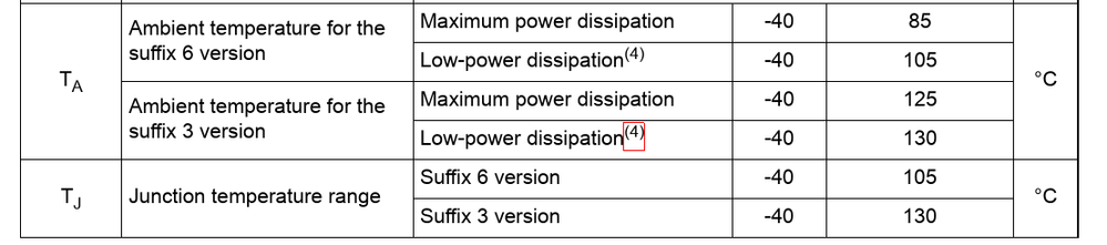

2024-05-01 11:39 PM
Right, from ds it should stay in/under these limits at all temp in allowed range.
(suffix 3 or 6 - look, what you have)
2024-05-01 11:00 PM
from ds :
So you know : prop.delay 15..31ns, offset -9 ... 3 mV , at -40...125° ambient .
If you need faster or higher precision comparator, use separate precision comparator chip.
2024-05-01 11:31 PM
ok Thanks
so shall i can consider no wall these reading for max 3mV and 31nS at 3.3V is at 125 deg C ambient.
2024-05-01 11:39 PM
2024-05-01 11:53 PM
STM32G474VET3
yes i have this suffix 3 for high temp grade -40 Deg C to +125 Deg C
Thank you so much Asch.3
