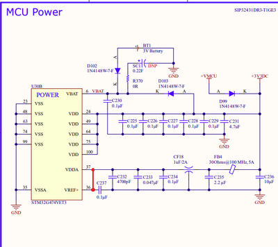

2025-05-07 6:05 AM
I think if you update this circuit by connection VREF+ also to 3V3 as VDDA, ADC will work correctly.

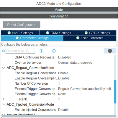

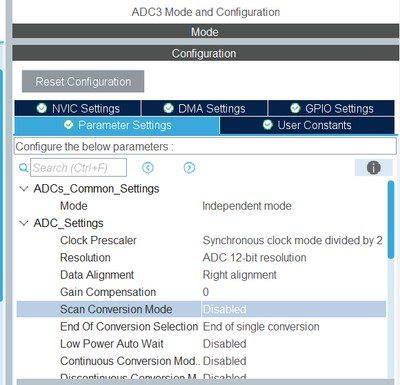

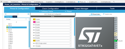

2025-05-07 12:52 AM
can you please share your ADC settings.

2025-05-07 1:17 AM
Sure

2025-05-07 1:21 AM
2025-05-07 1:38 AM
That doesn't show the STM32.
Also, you said "all the ADC channels I’m using"; that shows two - are there any others?

2025-05-07 1:46 AM
The configuration seems to me OK. Can you share also the code where is used ADC and read raw ADC value?
