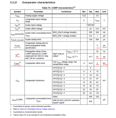

The propagation delay and offset error mentioned below for integgrated comparator.
Can it be changed at higher temperature at 125 Deg c.
So what will drift in propagation delay and drifts of comparator value at higher temperature lets say at 125 Deg C or at higher temperature.
Also the DAC settling time can be changes w.r.t. temperature if yes then what is the drift in that case?
