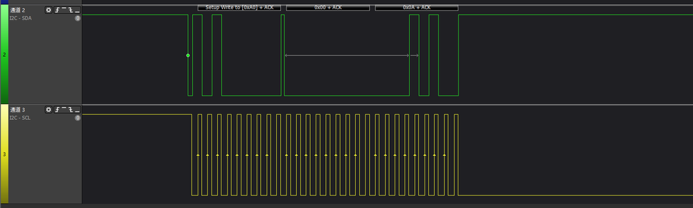

Google translate: stm32G474RET6 uses HAL IIC and M24C64 communication, the communication is abnormal
Still not enough detail. Looks like the SCL is held low. Show the full code used to produce this.

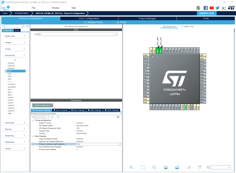

This is the cubeMX configuration

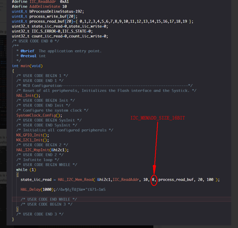

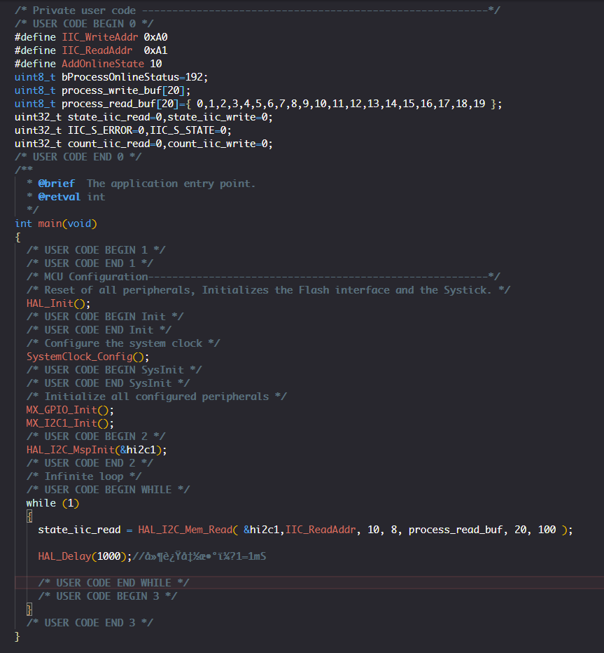

Code generated by cubeMX

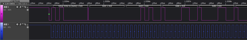

This is using NUCLEO_STM32F412RG development board, using IIC and M24C64 communication, this waveform is ok

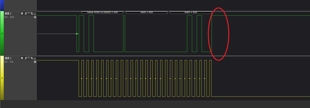

This is using NUCLEO_STM32G4 development board, using IIC and M24C64 communication, this waveform is abnormal
Please help analyze, is it the HAL library problem, or my problem, thank you very much for your help

The problem is solved
The macro definition is wrong. After correction, the problem is solved
