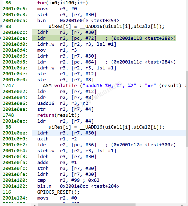

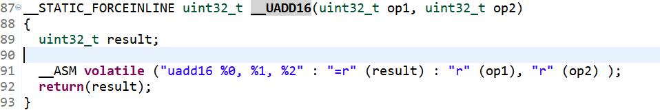

The figure2 is the body of __UADD16(), and the figure1 is the corresponding disassembly
figure 3

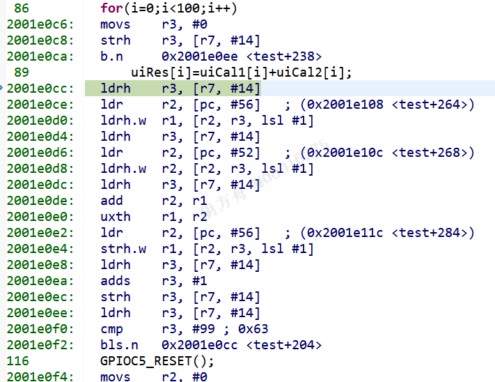

The figure3 is the disassembly of uiRes[i]=uiCal1[i]+uiCal2[i];
It can be seen that the figure 1 has more disassembly instructions than figure 3.
