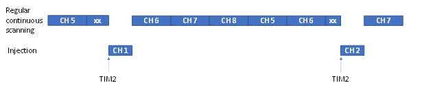

I am trying to set up my NUCLEO-G474RE board to perform ADC regular scanning mode using DMA with 4 channels and also discontinuous injection with 2 channels as shown below.
But when I run my code the injected channels always return zero or one, even if I connect their channel to 3.3V. It seems to be sampling the injected channels but for some reason instead of being connected to the actual pins their are tied low internally.

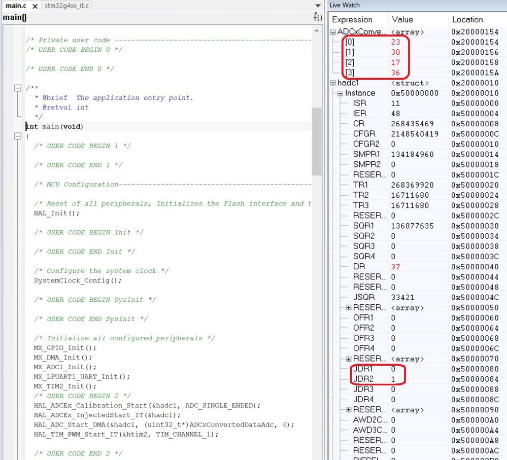

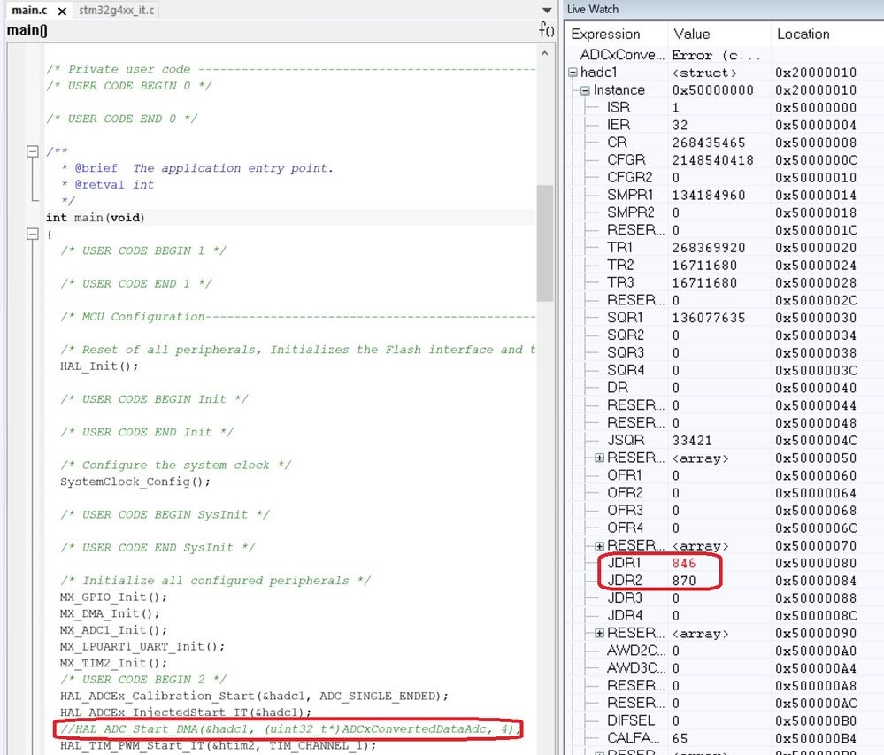

/* USER CODE END 2 *If I comment out “HAL_ADC_Start_DMA�? I can see my inject channels sampling random values every second as configured from TIM2.
But when I run with “HAL_ADC_Start_DMA�? I can see the 4 random values being continuous being sampled, but now my injected values only report zero, or sometimes ones.

2021-04-14 8:46 AM
Hi CHossack (Community Member) ,
This is limitation of STM32G4 ADC in Rev Y only (your chip has Rev Y). See please STM32G4 devices erratasheets for workaround (chapter: "2.7.8 ADC channel 0 converted instead of the required ADC channel").
In STM32G4 Rev X is this limitation removed.
Regards
