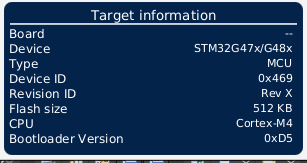

Bootloader Version is 0xD5

Bootloader version is 0xD5, which says no limitations. I have also tried moving the stack pointer per the 0xD4 limitation, still did not work.
