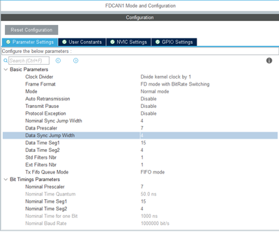

I'm using CANFD on stm32g431kbu6 board, but I find some issue that CANFD cant work normally with BRS ON,my config of CANFD show in the comments。Does anyone know about this?
Thanks

You need to increase TSEG1 and TSEG2 as much as possible an decrease the prescaler either for Nominal or data phases.
TSEG1 ~= 80% (TSEG1+TSEG2) for sampling point at 80%

Hello and welcome to the community.
First, please see these guidelines when posting:
Second, as stated in the guidelines above, you need to provide more information.
Need also to share your project, schematics if possible. Hard to tell about your issue based on the few lines you posted.

OK, and I find the reason, there is another CAN node with inconsistent data area sampling points (80%)in my CAN bus,my setting is 75%,so when it work together, CAN bus hang up
2024-05-06 6:08 AM
Thank you for the feedback. But I'm not sure the issue is related to the sampling point. 80% or 75% as sampling points position don't make a difference, it could be something else .. May be it's a resolution of the bit time issue based on time quanta of that another CAN node.

I find some issues in different config of FDCAN,
my configs list below:

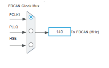

PCLK of FDCAN is 160MHz
Data Prescaler:8
Data Sync Jump Width: 1
Data Time Seg1:2
Data Time Seg2:1
When I config like this, I saw that the TEC keep increasing until the CAN controller enters bus-off status, then DLEC changes from 0x100(Bit Error) to 0x111
But if I make some change,it works well, configs list below:
Data Prescaler:4
Data Time Seg1:5
Data Time Seg2:2
So whats the minimal value of Data Time Seg1 and Data Time Seg2?
Data Prescaler:8
Data Time Seg1:2
Data Time Seg2:1
Data Prescaler:4
Data Time Seg1:5
Data Time Seg2:2
But this is not the values you shared in your first comment.. Otherwise I did suggest you to change this.
