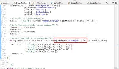

i a trying to figure out, why my fdcan is not sending databytes. It only sends the id.
And i think i found a bug. Or maybe its just me having not enough knowledge to comprehend it.
In the function "FDCAN_CopyMessageToRAM" there is a part, where the data length is bit shifted to zero.

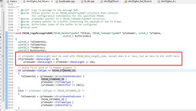

I found the problem and fixed the issue: I was not using "FDCAN_data_length_code" for the data length.
I added this to the code to make it work using it without "FDCAN_data_length_code":
 IF it is NOT the actual "length", it should be named "lengthCode"... :thumbs_down:

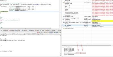

I removed the bit shift, and the bytes are transferred to the txAddress. But still it wont send the bytes. I feel like i am on the complete wrong track? But the bitshifft still makes no sense at all to me.

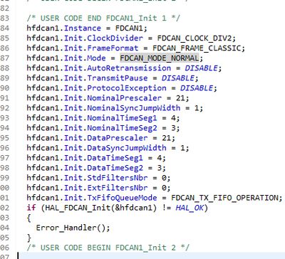

Show more relevant code. How are you initializing the FDCAN_TxHeaderTypeDef and data?
If a reply has proven helpful, click on Accept as Solution so that it'll show at top of the post.
CAN Jammer an open source CAN bus hacking tool
CANableV3 Open Source
I added the init code.  But cant you tell, that any uint8_t shifted 8 or more bits to the right is always 0?
