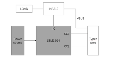

I'm not using the X nucleo DRP. The hardware Structure I am using now is roughly as follows:
The INA219 is used to monitor the VBUS voltage and current.
And the project is attached below.

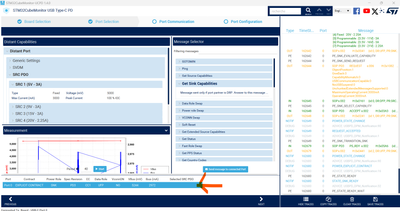

I am facing an issue with SRC PDO selection in cubemonitor.
Explicit contract has done correctly but unable to select a source PDO.
Do you have any solution for it!
