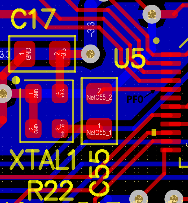

If there are experts here on board tracing, please tell me whether such a board layout can affect the operation of the generator (at a frequency of 40 MHz)? Underestimate its amplitude. Textolite 1.6 mm, red upper layer, blue lower layer. The filling of the polygons of the lower layer is continuous.

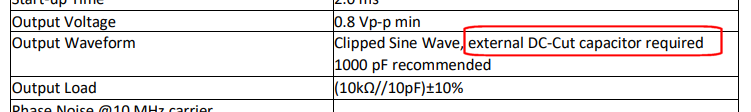

@CrazyChel wrote:I use FT2MN at 40 MHz.
So this: https://abracon.com/datasheets/FT2MN.pdf
@CrazyChel wrote:the amplitude at the output of the generator is no more than 0.6 V. According to the data sheet on the STM, the input of PF0 should be much higher.
The datasheet says it could be 0.8V - so not necessarily much higher.
@Peter BENSCH has already given the input requirements of the STM32 - and that certainly is very much higher than even 0.8V !
The TCXO datasheet also says:
But Peter has already said that a capacitor link will not work with the STM32.
It sounds like you have selected the wrong part for this application.
Perhaps you should discuss your requirement with Fox and find what they would recommend here:
https://abracon.com/support/tech-support-form
