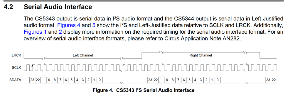

}Here is the data format sent by the ADC from the Cirrus Logic document for the CS5343:

If properly configured, SAI performs the one-bit-shift in I2S protocol for you, read the SAI chapter in RM.
Also note, that ADCs (and CODECs generally) usually work in two's complement, i.e. you need to sign-extend the value after right-shift. Casting to signed integer.won't do.
The most illustrative thing to do is feed the ADC first quiet (ground) then an easily recognizable pattern (I recommend sawtooth), and observe the actual data "manually" in debugger, as they go through your computations.
2023-06-09 4:08 AM
Hey, thanks for your reply. I've checked it and apparently CubeMX sets this parameter for shifting the data automatically depending on the configured protocol.
And also thanks for the hint regarding the sign extension. How could I forget it? I will adapt my code and check it with a sawtooth signal. That makes totally sense for testing.
2023-06-09 12:17 PM
Ok, for others finding this thread through the search engine or whatever, the data is already processed by the HAL driver and can be used without further processing directly. Not even a single shift operation!
2023-06-10 5:31 AM
As Jan already said, the processing is done by SAI hardware, not the HAL driver!
2023-06-10 8:55 AM
You are right. When receiving, the bits are ignored by the SAI hardware depending on the start position set by FBOFF and/or if the data size is smaller than the slot size.
