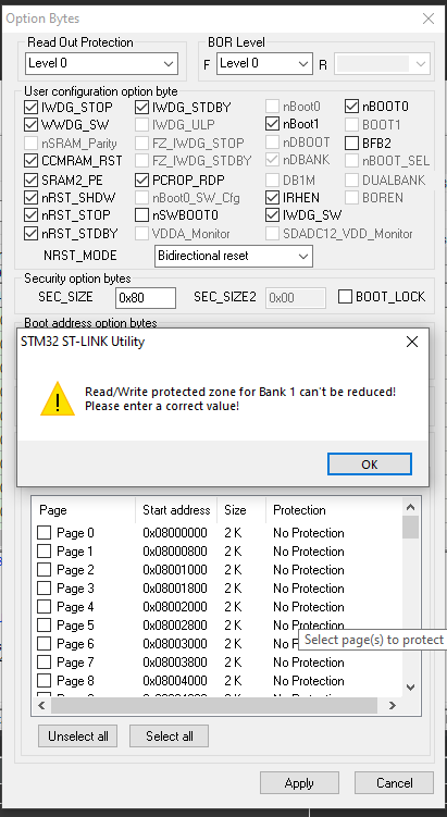

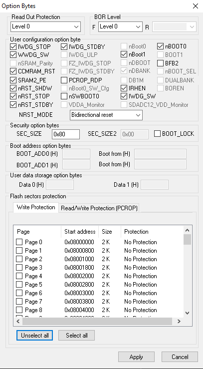

I´m currently working on an Application using the "new" G431 µC. At first i had massive Problems getting it to not crash (Several Hardfaults occuring here) randomly after ~100 instructions (not timing related...). After a while my good friend the readout protection showed up again and tried to see how my problem solving skills developed since our last meeting. This time i had to surrender, ive tried almost any setting i can imagine off (using st link utility) but everything it says that there are some settings invalid but doesnt let me change them either. Maybe some off you can give me some hints whats going on here, if this struggle continues this way im forced to switch to an other mcu i can count at ;(

i know that hardfaults have a reason and maybe they are hidden by something different i dont know atm.
I try to set some option bits according to the windows that told me i cant erase the flash with current rdp settings but wont hit my the apply button without a new error

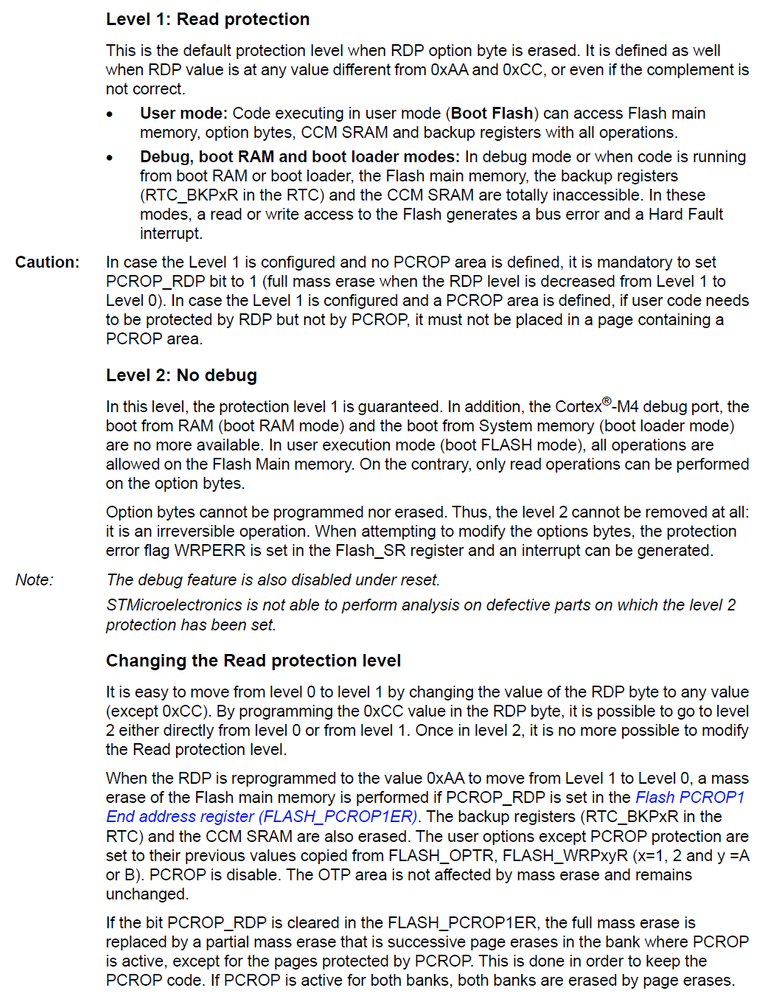

If you're in RDP level 2, you can't change it. Ever.
If you're in RDP level 1, set PCROP_RDP to 1 and apply before moving to level 0.

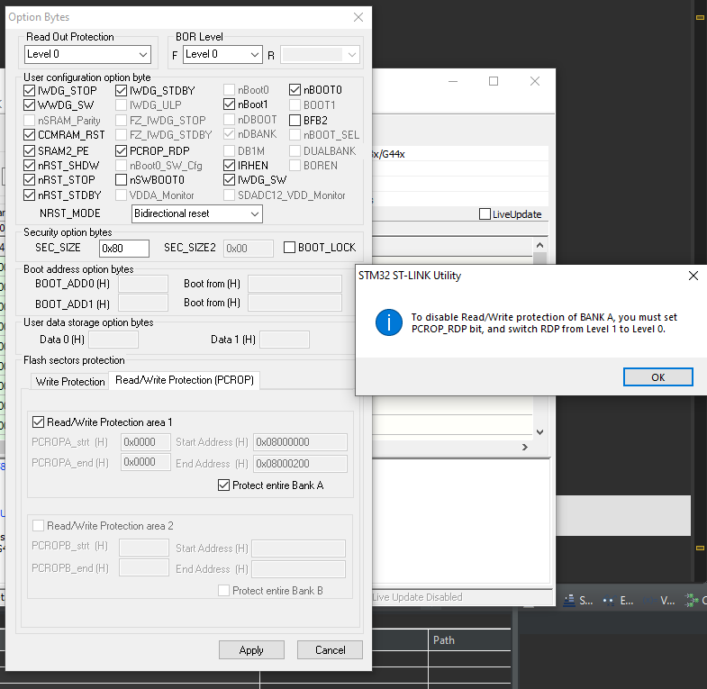

Yes you are completely right, this is the way i proceeded the first time ive encountered this Problem. Now it says its in rdp Level 0 but doesnt let me modify the Flash nor its settings. The other Tab in the Utility says something different where the rdp is set for Flash Bank 1, setting the PCROP_RDP flag isnt Posible because its says that the rdp Level cant be reduced to Level 0
So it both says it's in level 0 and that it can't be reduced to level 0? Perhaps a better description of what's happening, or a screenshot of the configuration and errors you're getting.

as you can see above i cant really change any of these settings without getting an error
