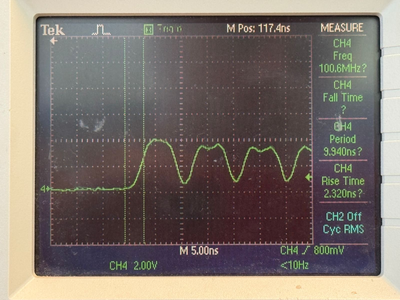

Currently, I am able to drive the signal at 40MHz and still get a decent square signal with a bit of over and undershoot, however, pushing above these speeds causes signal degradation and distortion. The rise/and fall times for the wave seem to be too slow, causing further problems.

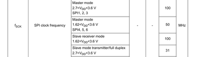

SPI on H743 can have a clock up to 100M :

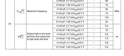

If pin speed set to very high , pin will switch fast - really fast :
110M , but at 10pF load ! So if you connect your (standard ? ) probe, at 10:1 setting, it will add about 10pF load to the pin/line....You cannot measure it with a standard probe and a scope.
Just believe the ds: it IS switching at ~ 3ns rise/fall times, but your connection has to be short, damped with a series resistor and low capacity...if you connect a cheap standard probe - its "game over".
I'm working with the H7S3L8, also, my digital oscilloscope is 200 MHz rated, using a 10:1 probe also rated for 205 MHz, so I believe in terms of capacitance this should be within range. I even tested this with a 500 MHz rated scope.
I added a 100 Ohm resistor to the load and I am able to see a more clean signal at 100 MHz, but the fall and rise time are still an issue.
I agree that datasheet specifies the performance conditions, but my testing probe seems to be within the bounds of the specification. So, considering @TDK's comment as well, could the traces on the board be adding enough capacitance to see such a decrease in the signal's quality and time response?
Fine, so you know: your probe+scope working fine at 40 MHz , square wave = to see a 40M square, you need at minimum 3. and 5. harmonic, thats 200MHz !
So everything fine - except your expectation, to live not in our universe and its physics.
To see something like a 100MHz sine, you can use your probe+scope , as this is in its capabilities.
For 100MHz square, at least with 3. and 5. harmonic, you need a > 500MHz probe+scope.
To see a real good square, need 9. harmonic minimum, so a > 1GHz probe+scope would be needed.
And ultra low capacity probe, with < 20mm wires signal AND ground to probe...really difficult and expensive.
