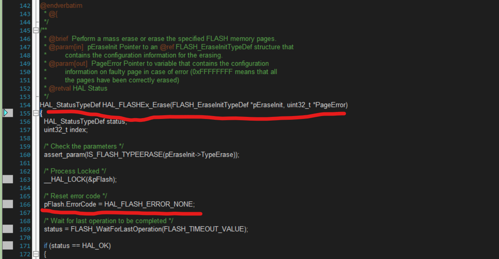

@JHOUD what exactly is this pFlash.ErrorCode?
i got this variable in HAL_FLASH G0 header file. i put screenshot of function
