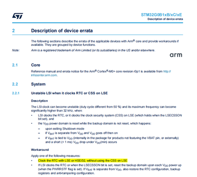

2025-01-20 5:35 PM
It's not certain whether this is caused by this defect, but it is indeed mentioned in the errata manual.

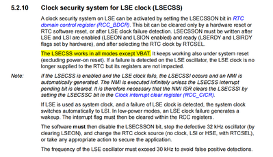

2025-01-20 1:27 AM
Is the LSECSS detected after the power supply of the backup domain is switched from VDD to VBAT?
2025-01-20 5:35 PM
2025-01-20 6:39 PM
One solution that comes to my mind is to enable the PVD and disable the LSE CSS function within the PVD. Then this problem can be avoided.
