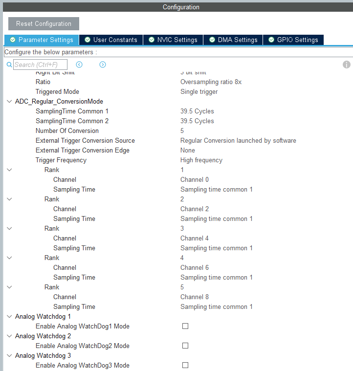

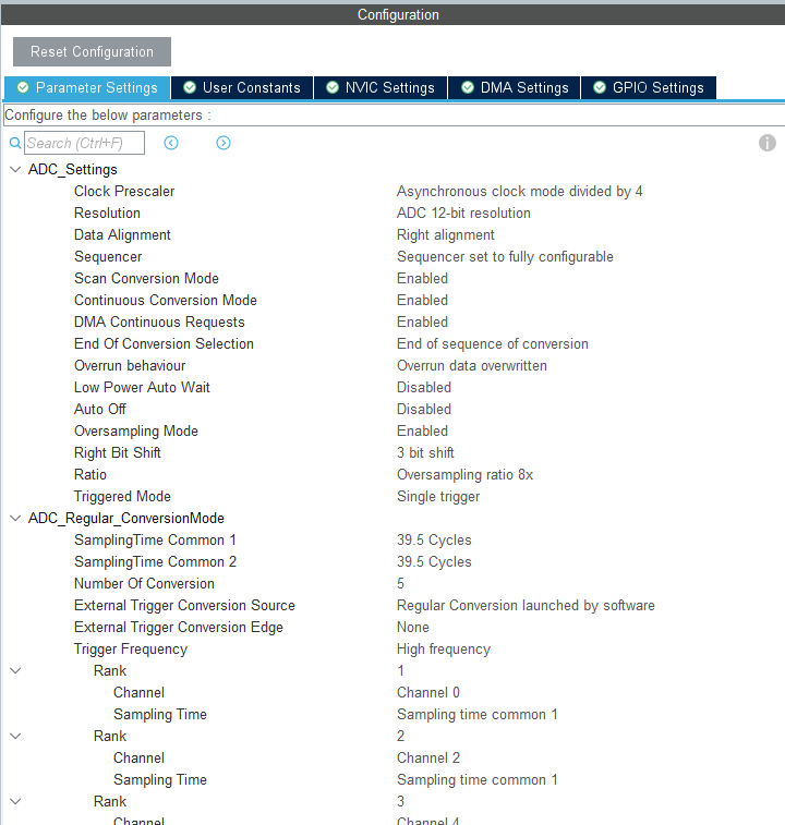

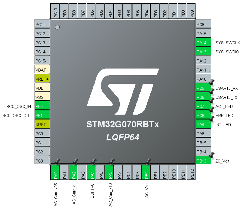

I am using STM32G070RB.
I need to sequentially receive values from 5 channels using ADC DMA.

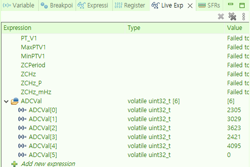

If normal circumstances, the ADC data of PA0 should be stored in Array[0] and the ADC data of PA1 should be stored in Array[1].
However, currently experiencing a bug where PB0's ADC data is stored in Array[0], and PA0's ADC data is stored in Array[1].
PB0's ADC data is a variable value, and the ADC data of other pins is a fixed value.
PB0's ADC data should come out with continuously changing values in the array[4].
Can you give me some advice where i made a mistake?

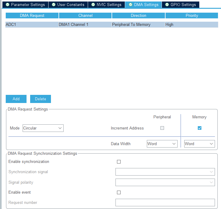

LL_DMAMUX_SetRequestID(DMAMUX1, LL_DMAMUX_CHANNEL_0, LL_DMAMUX_REQ_ADC1);
LL_DMA_SetDataTransferDirection(DMA1, LL_DMA_CHANNEL_1, LL_DMA_DIRECTION_PERIPH_TO_MEMORY);
LL_DMA_SetPeriphAddress(DMA1, LL_DMA_CHANNEL_1, LL_ADC_DMA_GetRegAddr(ADC1, LL_ADC_DMA_REG_REGULAR_DATA));
LL_DMA_SetMemoryAddress(DMA1, LL_DMA_CHANNEL_1, (uint32_t)ADCVal);
LL_DMA_SetDataLength(DMA1, LL_DMA_CHANNEL_1, 5);
LL_DMA_EnableChannel(DMA1, LL_DMA_CHANNEL_1);
LL_DMA_EnableIT_TC(DMA1, LL_DMA_CHANNEL_1);

A : The mistake probably come from a bad initialization sequence. I downloaded your code and, indeed, I observed the one byte shift in the ADCVal array. (IN0 in Array[1], IN2 in Array[2], ...).
