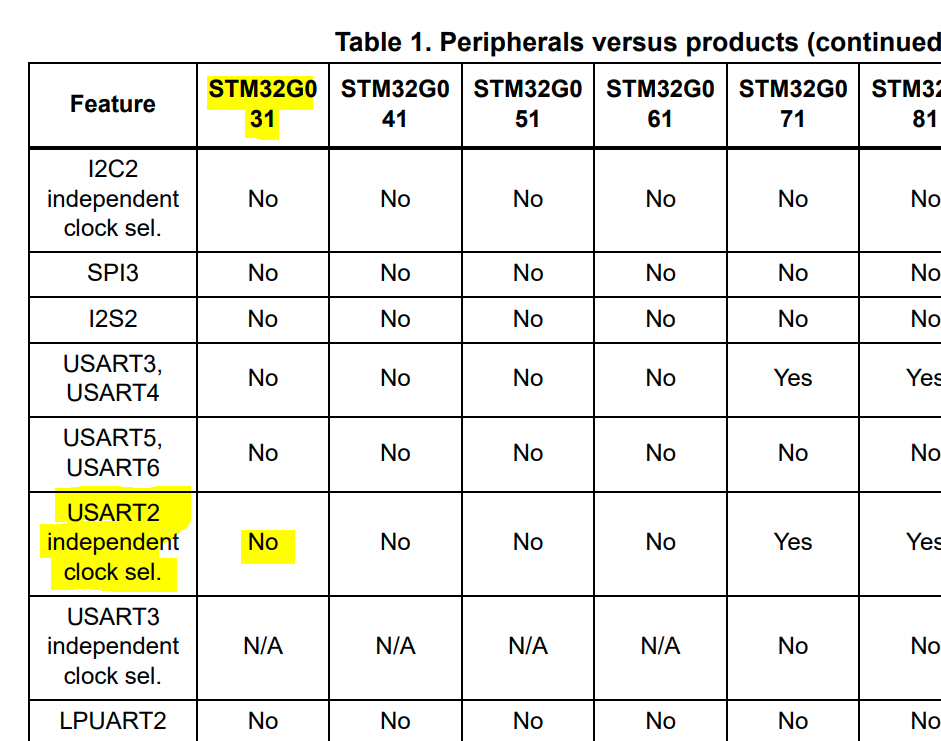

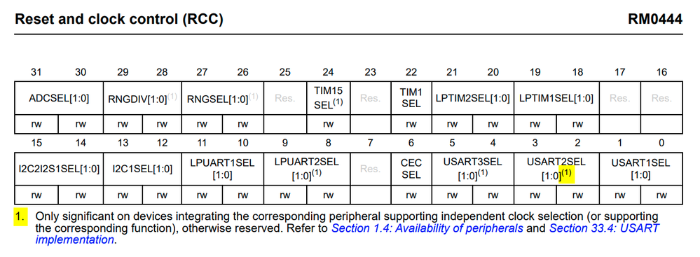

There is no clock configuration for USART2 on that chip so the USART2SEL field is reserved. There is a note saying it only exists on devices which implement independent clock selection:
And a further note saying STM32G031 is not one of them.
I would argue that the header file is correct not to include that field as it is reserved on that chip and that the real bug here is that CubeMX generates code that tries to access it.
