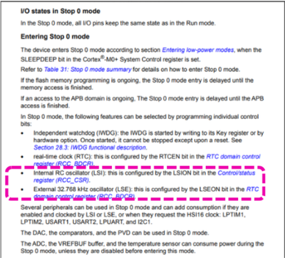

the reference manual stated that when using LSI to enter stop mode you should enable the clock individually by using this line of code
 /* USER CODE BEGIN 2 */
  __HAL_RCC_LSI_ENABLE();
  /* USER CODE END 2 */
using LSI or LSE without that line of code will not make the stm32 able to enter stop mode
