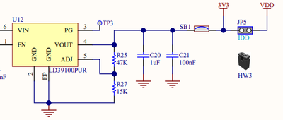

If all tests result in the same 100 µA consumption, and since you mentioned that the LED does not toggle, this strongly suggests verifying the measurement method. How are you measuring the consumption?
Here is a hardware implementation example of an IDD jumper from U083 (jumper 5).
Gyessine
Show your schematics how you create 1,8V and other power parts. For example Image from @Gyessine have R25,27 and this create passive current 53uA...
