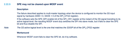

Hello @mdr and welcome to the Community :)
It seems you have encountered the condition when "SPE may not be cleared upon MODF event".
Please check the STM32U585xx errata sheet  (2.22.5 section) for more details.

Thanks for the swift reply, putting an
while (SPI3->SR & SPI_SR_MODF) { SPI3->IFCR |= SPI_IFCR_MODFC;}
before writing the SPE bit solved the issue :)
