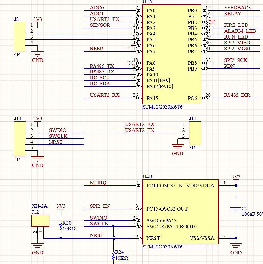

2022-06-24 2:47 AM
Hi Aatif Shaikh
i think NRST PIN need 10k to VCC
STM32 is low level reset,you Schematic NRST connect a CAP to gnd, so NRST PIN is alse LOW, so mcu is also IN RESET
see my Schematic。my board work well

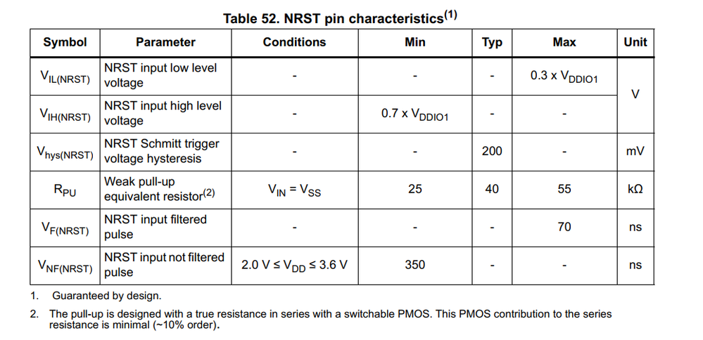

Yes,i do know DS12991 and AN5096, figure 5 and RPU pull-up.
And this is how a Datasheet - production data Table 52. NRST pin characteristics write: RPU pull-up. is a weak pull-up. (resistance value is not stable)
For a reliable product design, another strong pull-up make EMC good and make product stable for unpredictable disturbance, since NRST is important pin in system。 This is will not write on book or any datasheet, this is thousands of sets of product experience。Yes you do not need another strong pull-up if you just make some set toy , but one day if a jamming signal near the NRST pin, you will know how this strong pull-up resistor work. Do not always trust PCB layout engineer
