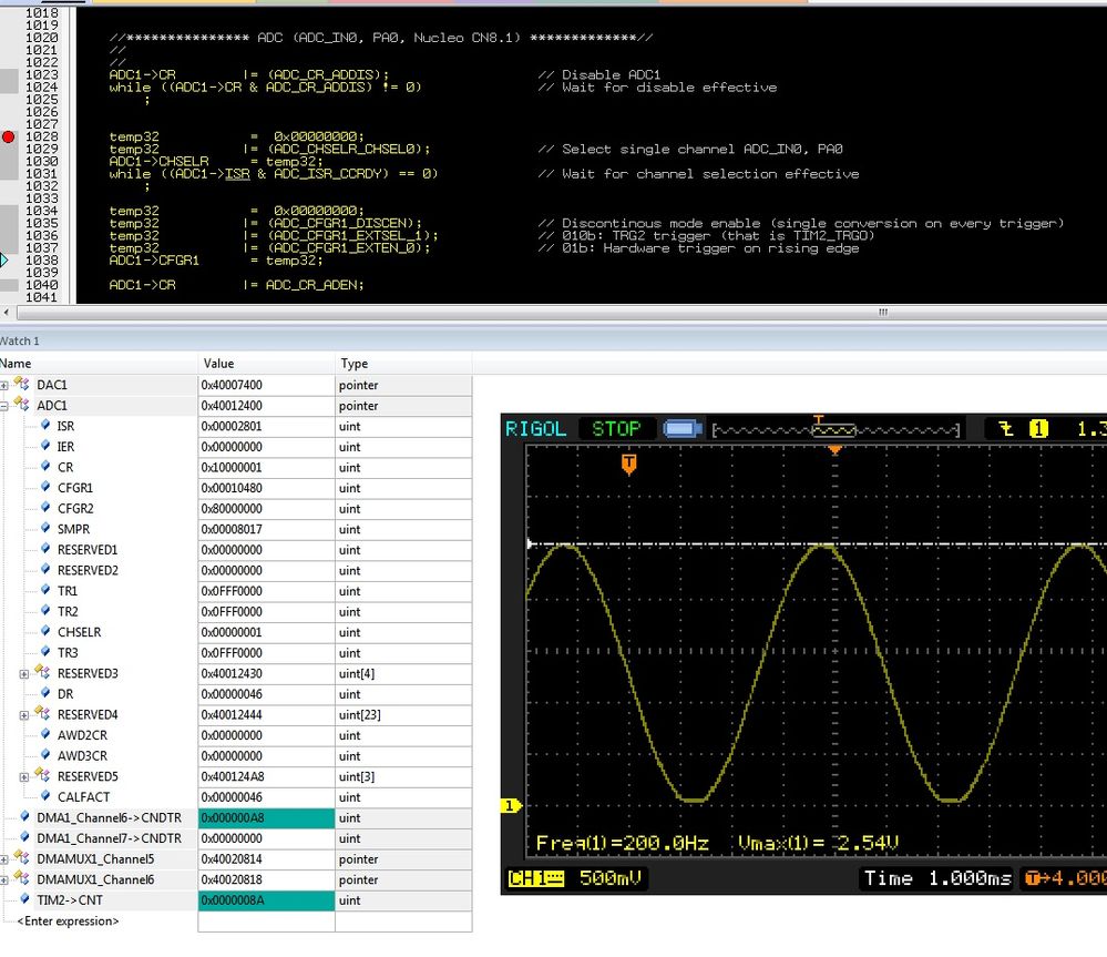

Using TIM2_TRGO to trigger DAC. That works.
Now want same TIM2_TRGO also to trigger ADC.
Is that possible ?

2019-09-18 2:50 AM
Still no TIM2 trigger of ADC.
DAC is running ok: TIM2 is running and triggers the DAC. DAC requests DMA and finally generates a sine wave of 200 Hz.
ADC in standstill with calibration value in DR. No trigger
Any idea regarding ADC triggering ?
Regards Juergen
2019-09-18 2:57 AM
Not sure about the G0 variant.
But be careful with the debugger. Live-watching certain peripherals registers will clear associated interrupt flags, and alter the program flow.
