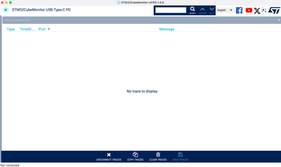

I am trying to use STM32Cube Monitor USB PD with custom board.
I see ST link v3 minie on a trace port. but I can't see any traces at all. Is there a dedicated package in CubeMX i can enable to see USB-PD traces ? Thank you.
